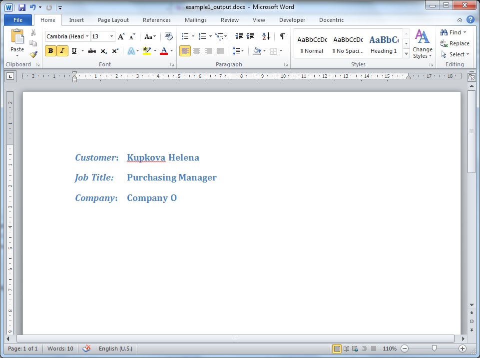

Now when we have a report template saved, we can proceed to generation of the report. Report generation takes place programmatically, from your application that is using (has a reference to) the Docentric Report Engine dll. This code looks like following:
    // Getting specific customer
    Customer customerDataSource = DataAccess.GetCustomerById(15);
    // Instancing report engine, by assigning the data source
    DocumentGenerator dg = new DocumentGenerator(customerDataSource);
    // Generating report by specifying the report template and the resulting
        report (as file paths)
    dg.GenerateDocument("example1.docx", "example1_output.docx");
It is also possible to invoke the method GenerateDocument with same parameters typed as System.IO.Stream.
