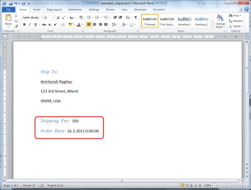

Generated report looks like:
Formatting values image
You can notice that the Order date and Shipping fee are not in desired format. In order to change this, set the property Format String of the Field elements bound to OrderDate and ShippingFee properties of the class Order to suitable values, like shown at the picture below:
