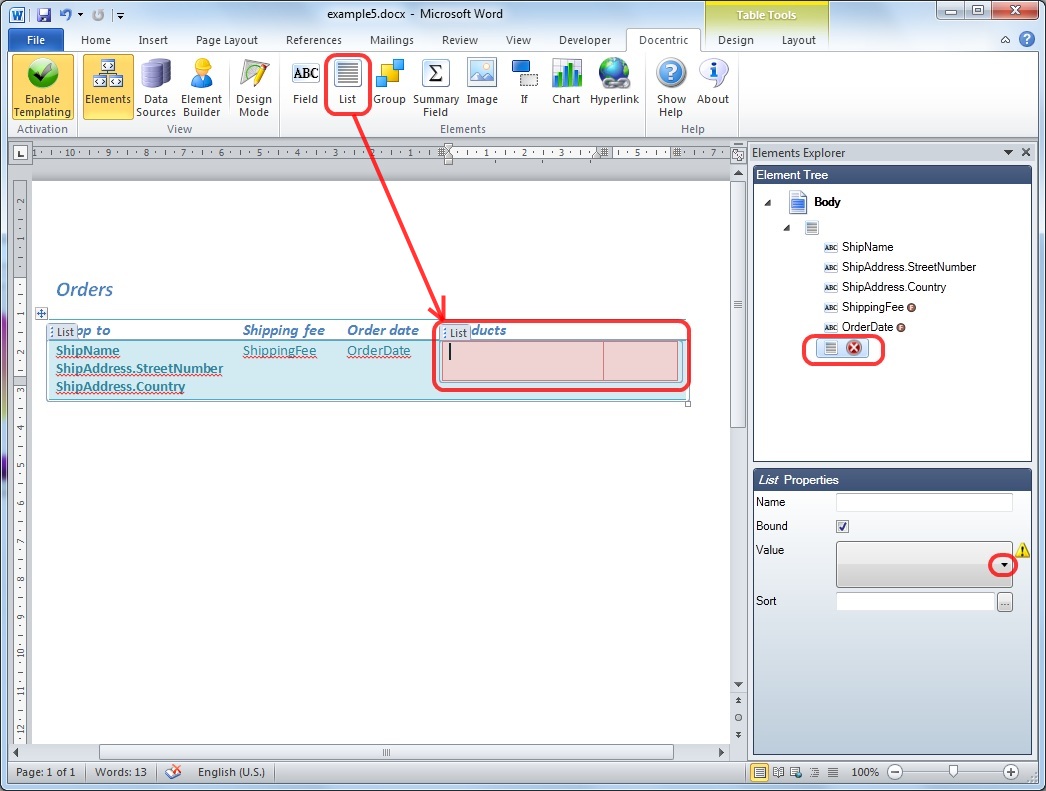

As the next step, insert a nested Word table for listing of products for each order:
Now add a Docentric List element from the Docentric Ribbon tab
(about inserting List elements you can read here) to the template in
a way that the whole row of the Word table is comprised.
